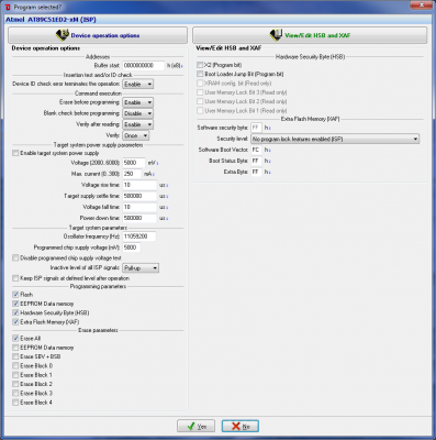

1. It's not clear to me what the Hardware Security Byte (HSB) check boxes indicate in the attached screen shot. When checked are they SET (1) (unprogrammed) or CLEARED (0) (programmed) for the X2 and Boot Loader Jump Bit (BLJB) check boxes?
2. Why are the HSB XRAM and "User Memory Lock Bits" grayed out as shown in same screen shot? This is not the case in parallel/ZIF mode where they are not grayed out.

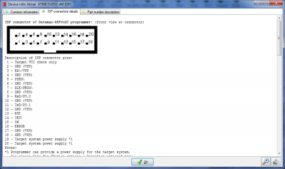

3. Why are the following MCU pins used in the ISP connector, see (2) screen shots attached, they seem redundant?
PSEN, EA/VPP and ALE/PROG
Our ISP adapter board does not have these pins connected. Our circuit board has MCU pins
PSEN, EA/VPP and ALE/PROG pulled HIGH. The ISP process seems to work and gives a success
message but our user app program never runs afterwards. The Atmel datasheet (could not attach)
does not mention that these MCU pins are needed in ISP.
They are CLEARED (0) (programmed) when checked. And they are SET (1) (unprogrammed) when unchecked.
Because they can only be read in ISP (UART) mode.
Quoted from Device info section of our software:
'Software security byte' is programmed by way of 'Security level'. If operating in ISP mode, it's not possible to unprogrammed already programmed HSB bits. These bits can be unprogrammed only while operating in ZIF mode (parallel mode).

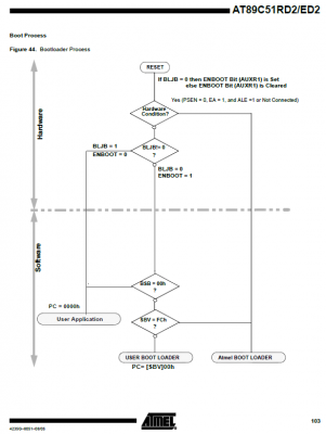

It is necessary to set them in accordance with the serial programming specifications as follows:
PSEN = 0, EA = 1, ALE = 1 or not connected.
Please see the related part of the datasheet for the explanation:
I hope this answers your questions.
