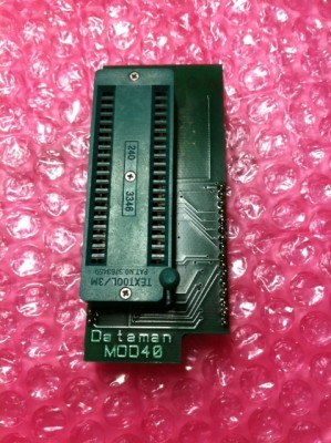

I am trying to firstly read a 27c4100 eprom, I find my 40pro does not support this so have gone back to my S4 as this does support this with the MOD40 adapter. (good job I kepted it)
My questions are
1) How do I know I have the right mod 40 adapter? I see there are 2 different types, I need the mrom one, so how do I tell which one i have?
I have tried doing a read but I don't see the data I know is contained within the rom, so my next question is,
2) If I have the right adapter how can I test it to see if it is working correctly? I do know my S4 is perfect and working well.
3) Does the 40pro support any 40 pin mrom types at all? I could not see any when I searched
Many thanks
Andrew
There are 2 modules for the S4. The Mod40 which uses the JEDEC format. Then the Mod42 which uses the MROM format pin-out. Any 42 pin EPROM is in the MROM format. If your EPROM is 40 pins you will need to consult our list to find out the format: http://www.dataman.com/dataman-s4-modul ... it-devices

Reading a device and using the EDIT button to see the data read from the device will prove that it is working.

All MROM devices are 42pin so are not supported on the 40Pro as it only has a 40pin ZIF socket.
