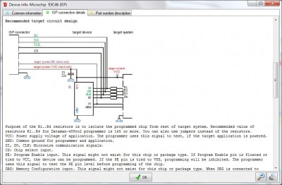

Which device are you working with exactly?

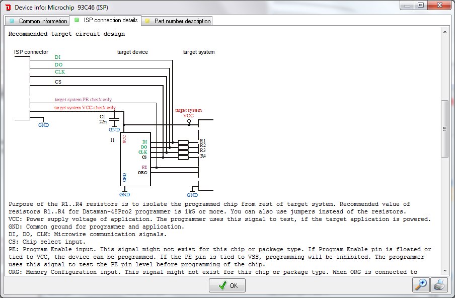

When you select a device in our software in ISPmode, for example: "93C46 (ISP)" we provide all the connection details including a schematic of our recommendation for connecting to the target device under the "Device info" section:

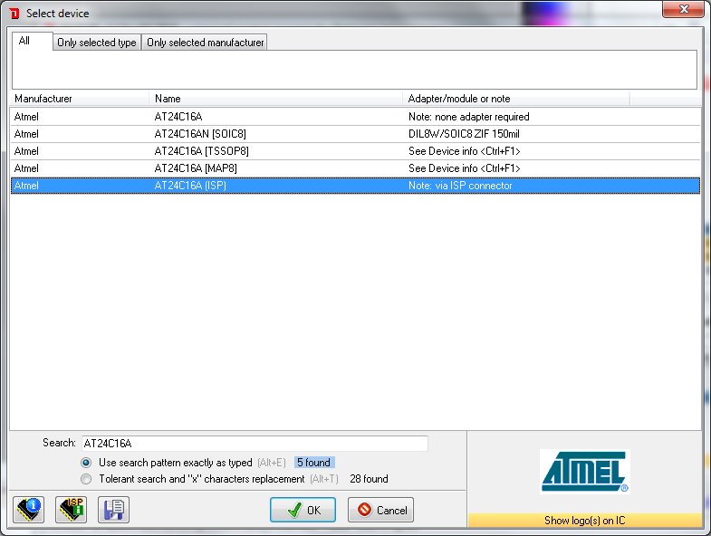

I want to program the AT24C16A EEPROM however, I have been looking at the Software for a while now and can not find where to select the ISP mode for the device.

Hello Paul,
Please make sure you are running the latest software version which is currently v3.12.

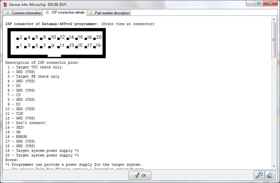

For the ISP connector, is it necessary I make Pins 2,4,6,8,10,12,17 & 18 all connected to GND, or I just need connect one of them to ground ?

All terminals that are marked ground must be tied to ground.

My target device is the AT24C16A EEPROM. Looking at the connection details, I have all connected to the target board except Pins 3,7,13,14,15,16,19,and 20. Pin 5 was connected to the target board as well as grounded. I hope this connections are right.
With the target system powered at 3.3vdc, I had a 2.2K pull up resistor connected to the SDA and SCL lines. I would believe this connection is right.
