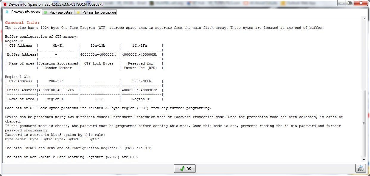

I could not find any mention of the Spansion part name "S25F512sagmfi01", perhaps it is the S25FL512S device? If yes, then the location of the special options are described in our software:
Of course, if the device has been protected then it is not possible to read the contents.
I hope this helps.
