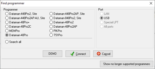

Please be sure to select the correct programmer type from the Find programmer dialog: If you continue to have problems then please provide a copy of the problem report showing the error message you are seeing. This can be generated using the (Help > Create problem report) feature in the software.
