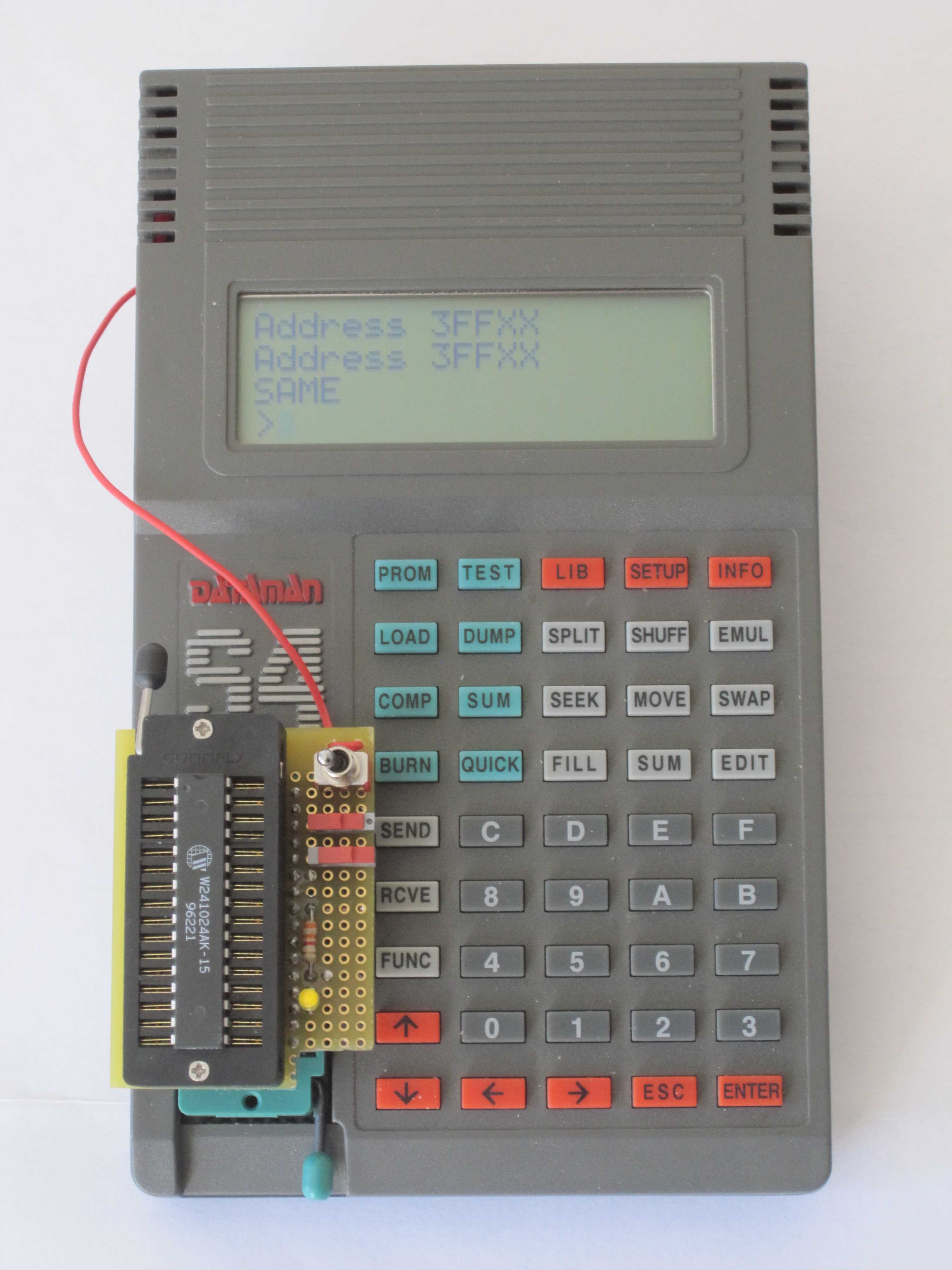

Hello,
I built up an adaptor to use with the NVRAM lib and – it works great!
In the picture testing of a fast static RAM (cache RAM) can be seen.
Pin 34 of the emulation header can be used to supply the RAMs. I noticed that Dataman counts the pins different to the connector producer. So according to the emulation cable details document it is pin 18.

Patrick
