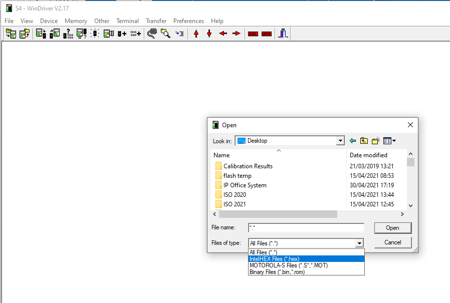

The procedure depends on how and where your data is located. If it is on a master chip then you can copy the contents into the S4 user RAM and then program it onto a new device. Or, your data could be in the form of a HEX or BINARY file on your PC, in which case you would need to use the S4 driver software and a 25 to 9 pin serial cable (and possibly a (USB to serial) adaptor if your PC/laptop does not have a serial port).
Once you have the S4 driver installed and the necessary cables it is just a matter of choosing the transfer option you need:
Choosing the data file and transferring it to the S4:
Once the transfer is complete and you have the correct device selected on the S4 (FUNC > PROM) it is just a matter of hitting the BURN key.
