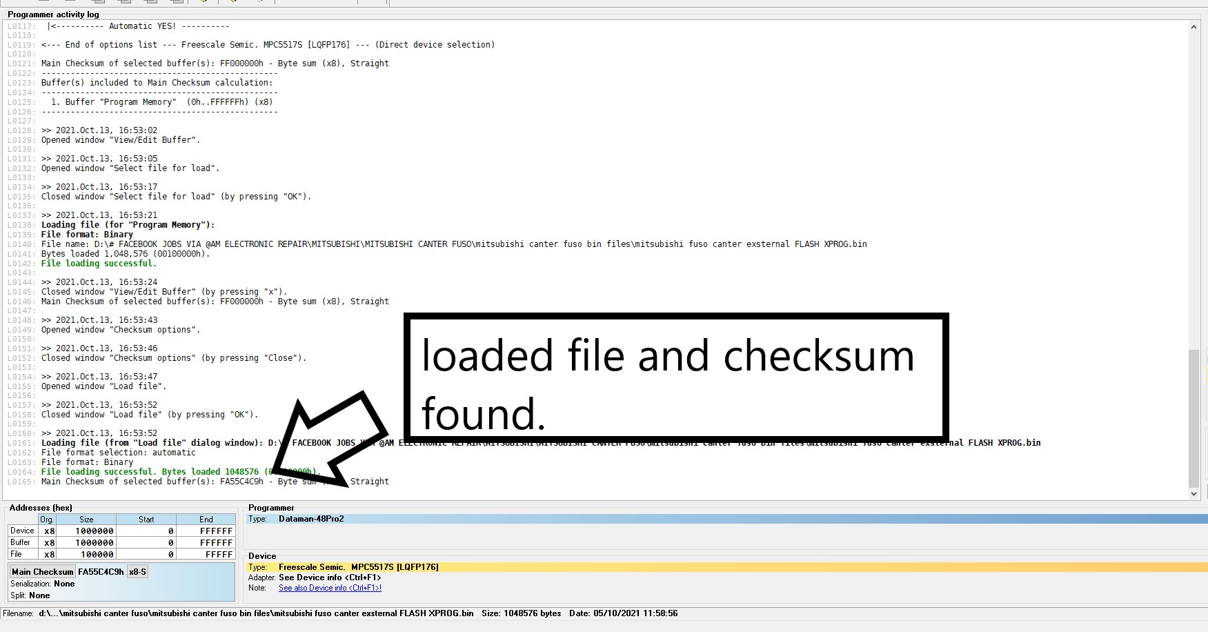

the picture below is me loading the file i wish to be able too perform a checksum on. currently the dataman doesn't have the chip loaded , so please ignore the fact a MPC chip has been selected.

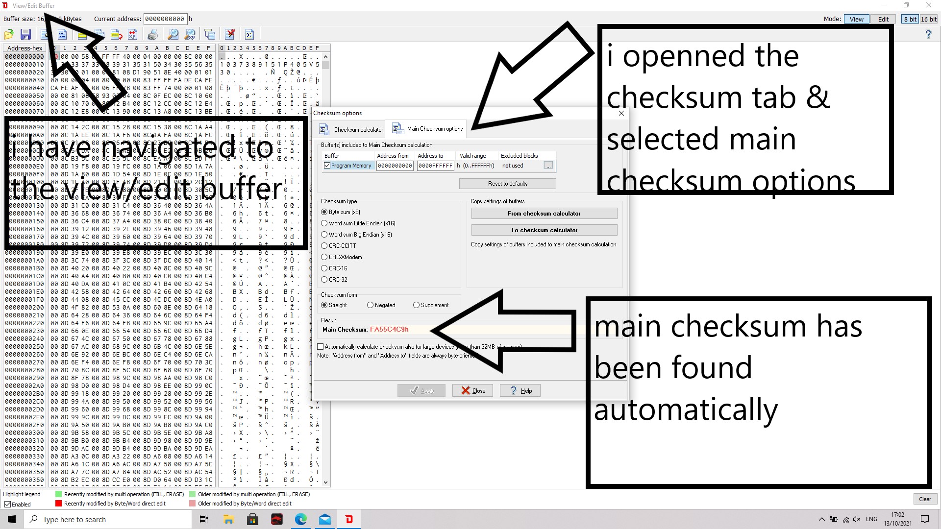

. the picture below is when i navigate to the view/buffer section. i selected checksum , and then clicked the main checksum options , the .bin files checksum has been found then i clicked the from & to option to fill the checksum information. i then pressed apply. then i moved over too the next tab then I pressed calculate & it has populated the info next it comes up with an error. but this is the bit that is a little confusing as its not exactly clear what that is meant to mean. so in summary what i want to do is edit this file shown in the examples , but recalculate the file and then flash it back to the target chip. but i keep getting an error which isn't very clear at all

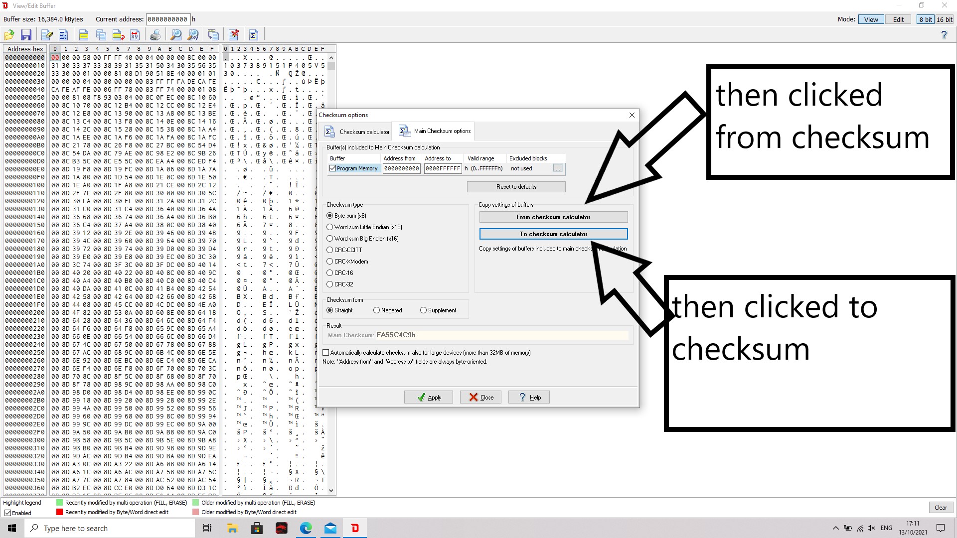

it looks like the pictures do not line up with what i am trying to explain..

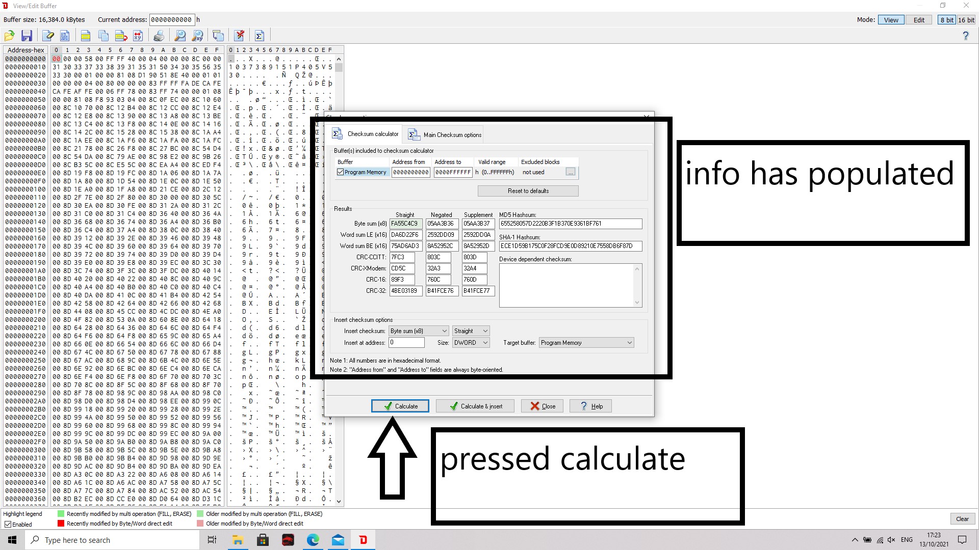

then i clicked calculate. and then it populated the info

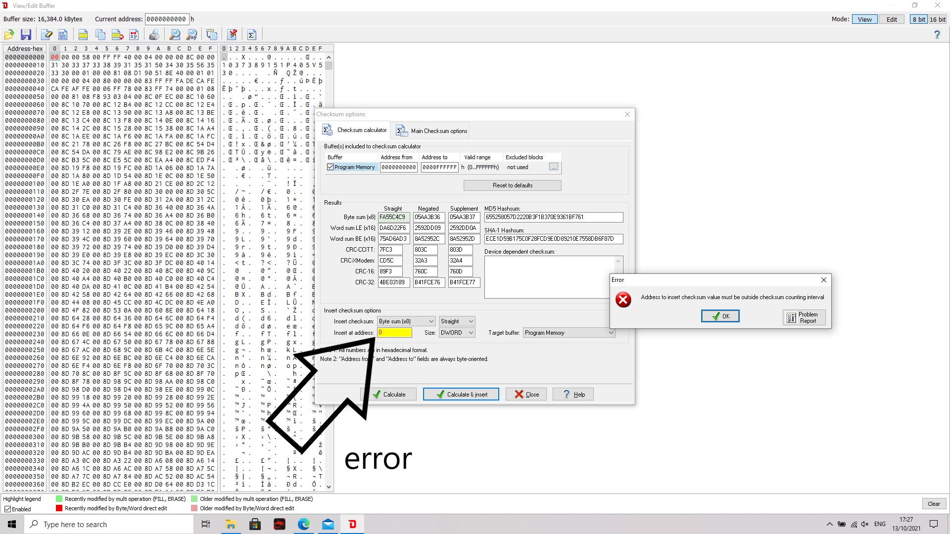

then i clicked calculate and insert but i get an error.

OK, the error message appears to be telling you that you cannot insert the calculated checksum starting at an address that was used as part of the checksum calculation itself.
You must specify an address outside the range of addresses that you were calculating the checksum over.
