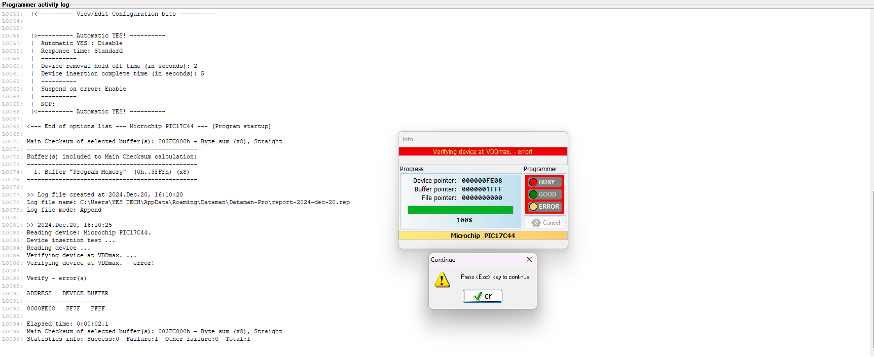

Hello everyone
i have this problem when i want read the chip. Also when reprogram, but i find a new one, the information into the chip is not the same like the buffer.
any help can be accepted. thanks in advanced

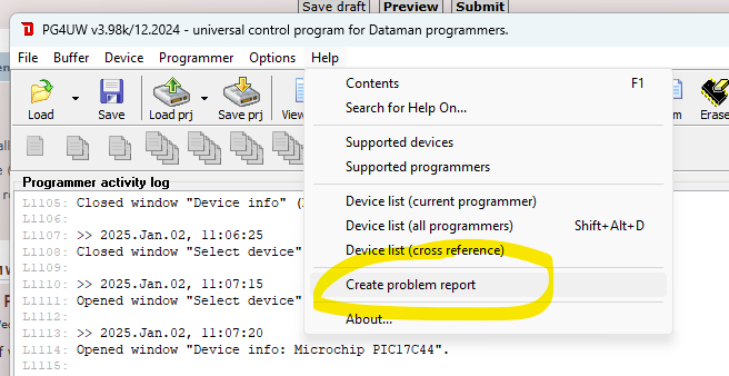

What is the result of a READ operation on this device? Can you perform this and then provide the full info-rich problem report using the standard method: Help > Create problem report. It is more useful than the screenshots and will give me the complete picture.

Hi I have something...

Postby Dataman (Neil Parker) » 03 Jan 2025 15:20
Hello,
We were not able to simulate such a problem with our samples. We tested all options for Verify, including +-10% VDD.
The problem source is local, it maybe the programmer itself.
Error - difference in data
0000FE08 FF7F FFFF
means something with the Config area.
If an identical error also appears in the case of setting the Verify once @ nominal VDD, it is most probably related to the DUT.
It might be also some HW error, but it is new programmer ... .

...when i want read the chip, i have this error...
