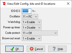

> When that time comes, how do I know that the CONFIG bits will be written to the new future IC's properly?
When you read a device with configuration options (as long as it is not protected) the config. settings will be read into our software and can be seen in the "View/Edit Config. bits and ID locations" dialog. This can be save to a project file which will include the program data and config. bits.

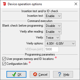

> Do I need to do something when reading my initial master IC so that the original CONFIG bits will be a part of the IntelHex file?
Not when reading the master, but when programming the new device you will need to make sure you check the "Configuration bits" option in the "Device operation options" dialog:
