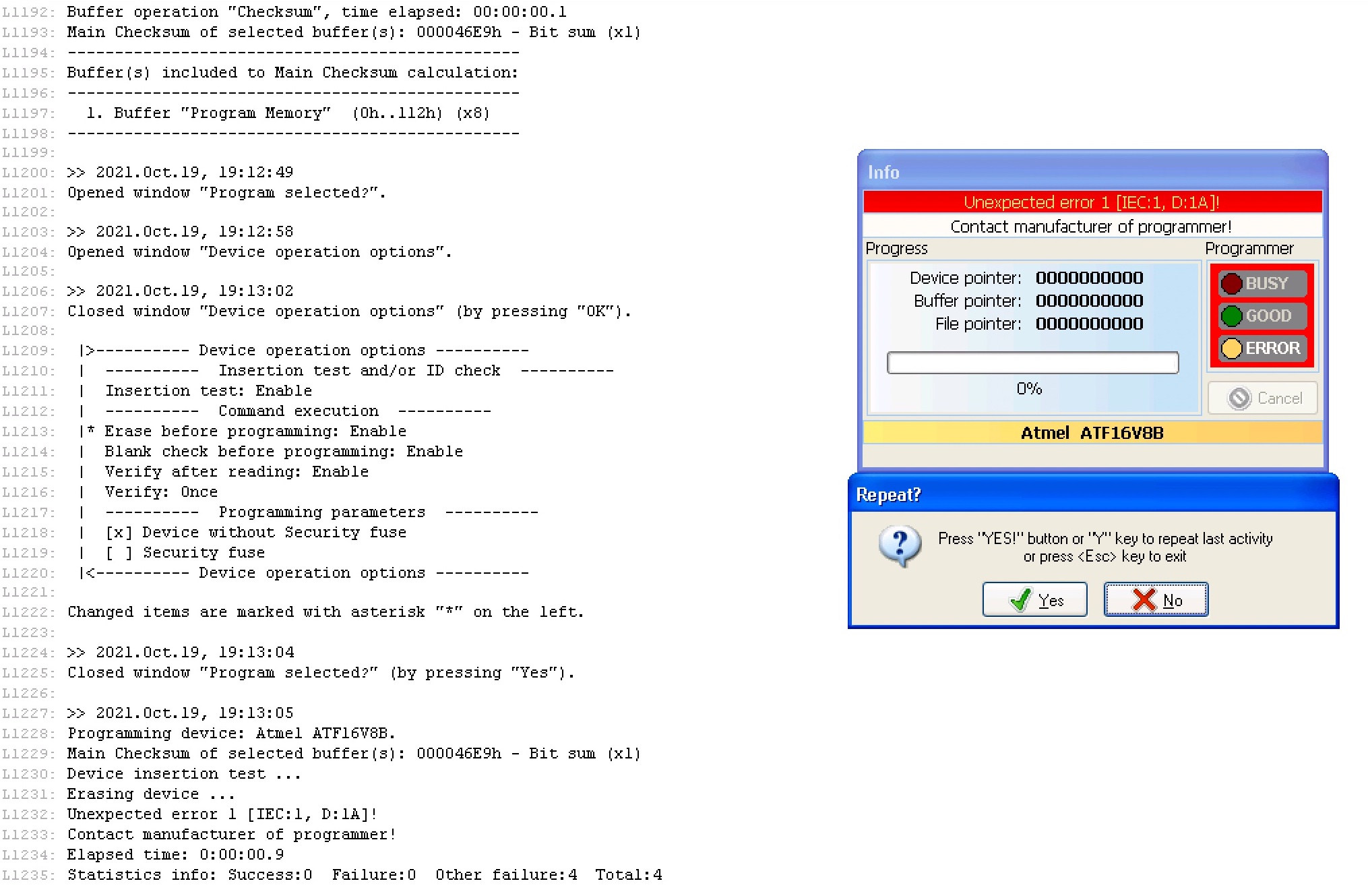

As titled after upgrading to v3.70 the programming of ics like Atmel ATF16V8 etc ics no longer works.
The error mentioned is: Unexpected Error 1 Contact Manufacturer of programmer
Screenshot also attached.
I've had to go back to v3.61
Programming ATF16V8 no longer works in v3.70

Apologies for the delay in responding. Can you confirm that the programmer model is the Dataman-40Pro and can you also confirm the result of the "Selftest..." from the Programmer menu using the diagnostic pod?

Yes the programmer is a 40 Pro (upgraded from a MEM Pro) serial 578-03481
I will run the diagnostic test thing but i know these ics program fine in the earlier software as i using 3.61 again and its working fine.

We have improved the code for the mentioned device.
Please download, install and use the latest OnDemand software:
URL: https://www.dataman.com/mwdownloads/dow ... nk/id/202/
Version: 3.71h/10.2021
Sorry for this inconvenience.
