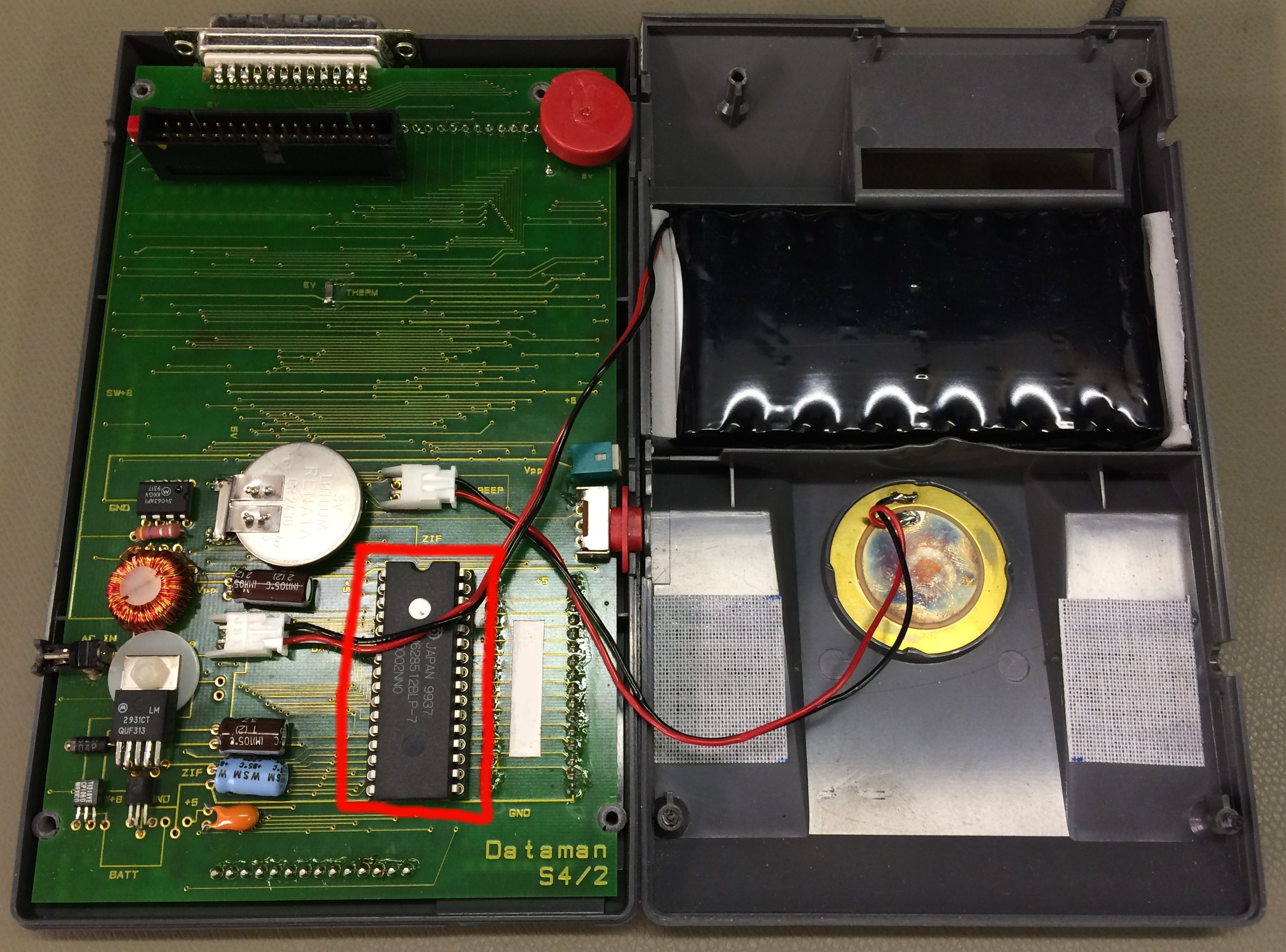

Re: URAM replacement required by a URAM fault on power up.
Hello Mario,
The S4 RAM chip is in a 32 pin JEDEC DIL package, it is identified in the following image:
Best regards,
Neil Parker
Dataman Programmers
Best regards,
Neil Parker
Dataman Programmers
Tank's a lot for these precision.
My memory, that I confused for a microprocessor is constituted with 2 superposed circuit boards containing 2 memory IC by board.
I think that your memory is the equivalent of my memory kit. The specifications of your memory is 512 kbyte and when I open my S4, the display show "512 k bytes ram".
I uploaded the picture of my memory module. I was not able to insert a picture in this reply.
