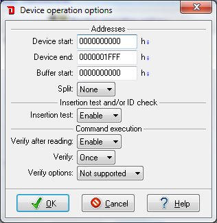

You have the option to choose the start and end address that you wish to program inside the device from the Device operation options dialog (Alt + O):
I hope this helps.

The "device start" address i'm using is 0 and "device end" address is 00003003FF
I've tried that option and indeed is reprogramming fine between the "device start" and "device end" but apparently everything after "Device end address" it is erased.
In the dialog window i have one more option "Erase before programming" which have to be enabled in order to rewrite the data, so i'm not sure if that can cause the erase for the rest of the addresses.
