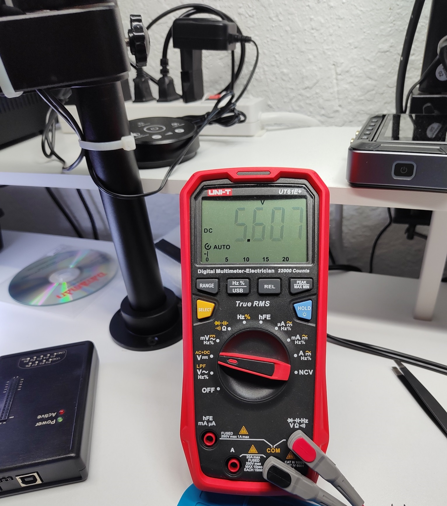

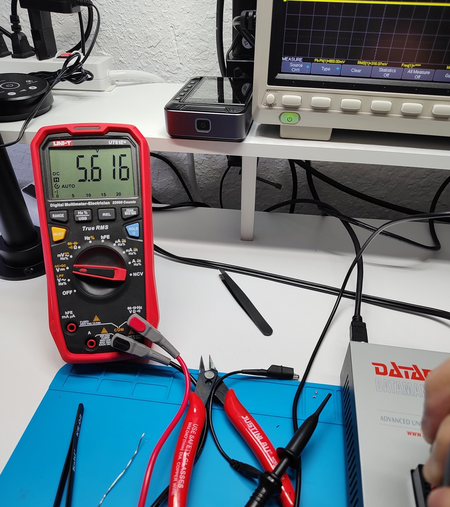

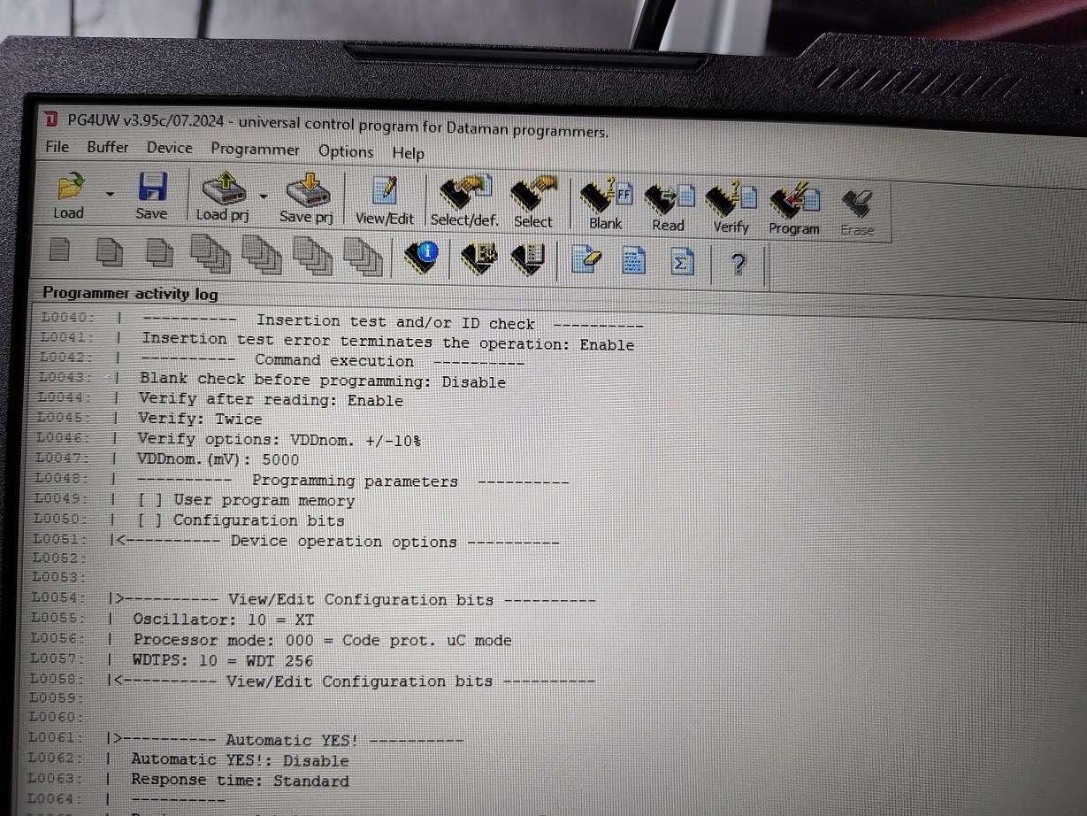

im maked some proof with differents capacitors, but i guess the Vdd is to high.. i can provide some pictures for you..
selftest-ok
vdd-5.6v
soft version-3.95c
capacitors- 1nF - 100nF between pin 1 and 10
https://drive.google.com/drive/folders/ ... sp=sharing
selftest-ok
vdd-5.6v
soft version-3.95c

We were not able to simulate such a problem with our samples. We tested all options for Verify, including +-10% VDD.
The problem source is local, it maybe the programmer itself.
Error - difference in data
0000FE08 FF7F FFFF
means something with the Config area.
If an identical error also appears in the case of setting the Verify once @ nominal VDD, it is most probably related to the DUT.
It might be also some HW error, but it is new programmer ... .
Basic operation for a new chip (if you are going to program it) is a Blank check.
0000FE08 FF7F FFFF
