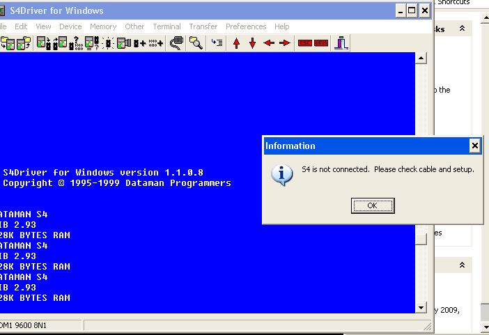

I have tried various ports and baud rates, but every time I try and send a file to the device its says
"S4 is not connected......."

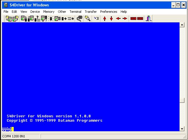

Oddly when I change the Comm port the device is sending a command back. (see attached image)
Any thoughts on what I am doing wrong.

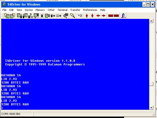

I have tried that and the devices appears to be connecting (1st image)
However the 2nd image shows the error when sending the file (Transfer/Download (PC > S4)
I have done this about 50 times over the last 10 years and never had a problem! Am I going mad?

The S4 driver software version you are using looks quite old, can you download v2.17 from our website here and try that: https://www.dataman.com/dataman-s4-resources
Please let me know how you get on.

Neil
I have installed the Windows version 2.17 and that has worked a treat,
