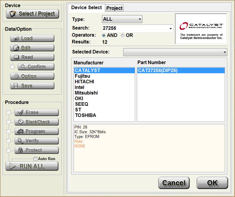

Can you add please add these two EPROM's - ST 88915 TS 27C256-25CQ And GI 27256-20 8702 cga pat 200
Thank you
Our engineers have said that you can select the CAT27C256 device in the software to program these devices.
If you still have any problems, please let me know.

Thanks Neil! That worked
