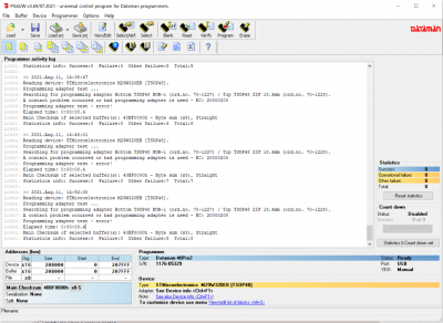

I am struggling to program a TSOP48 package chip using V3.69 dataman software with programming adapter Bottom TSOP48 NOR-1 (ord.no. 70-1227) / Top TSOP48 ZIF 18.4mm (ord.no. 70-1228).

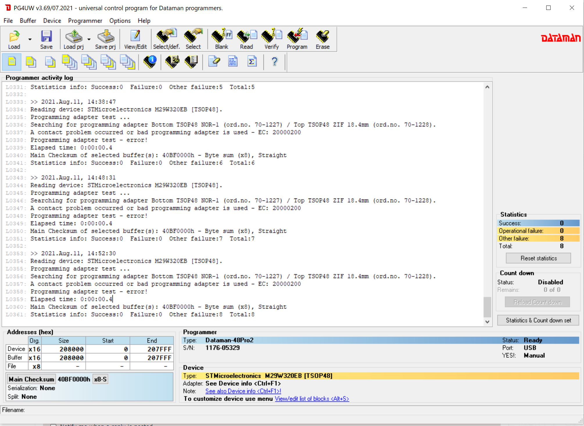

I get the following error each time:
A contact problem occurred or bad programming adapter is used - EC: 20000200
Programming adapter test - error!
I have cleaned the contacts and the pins and still the same error.

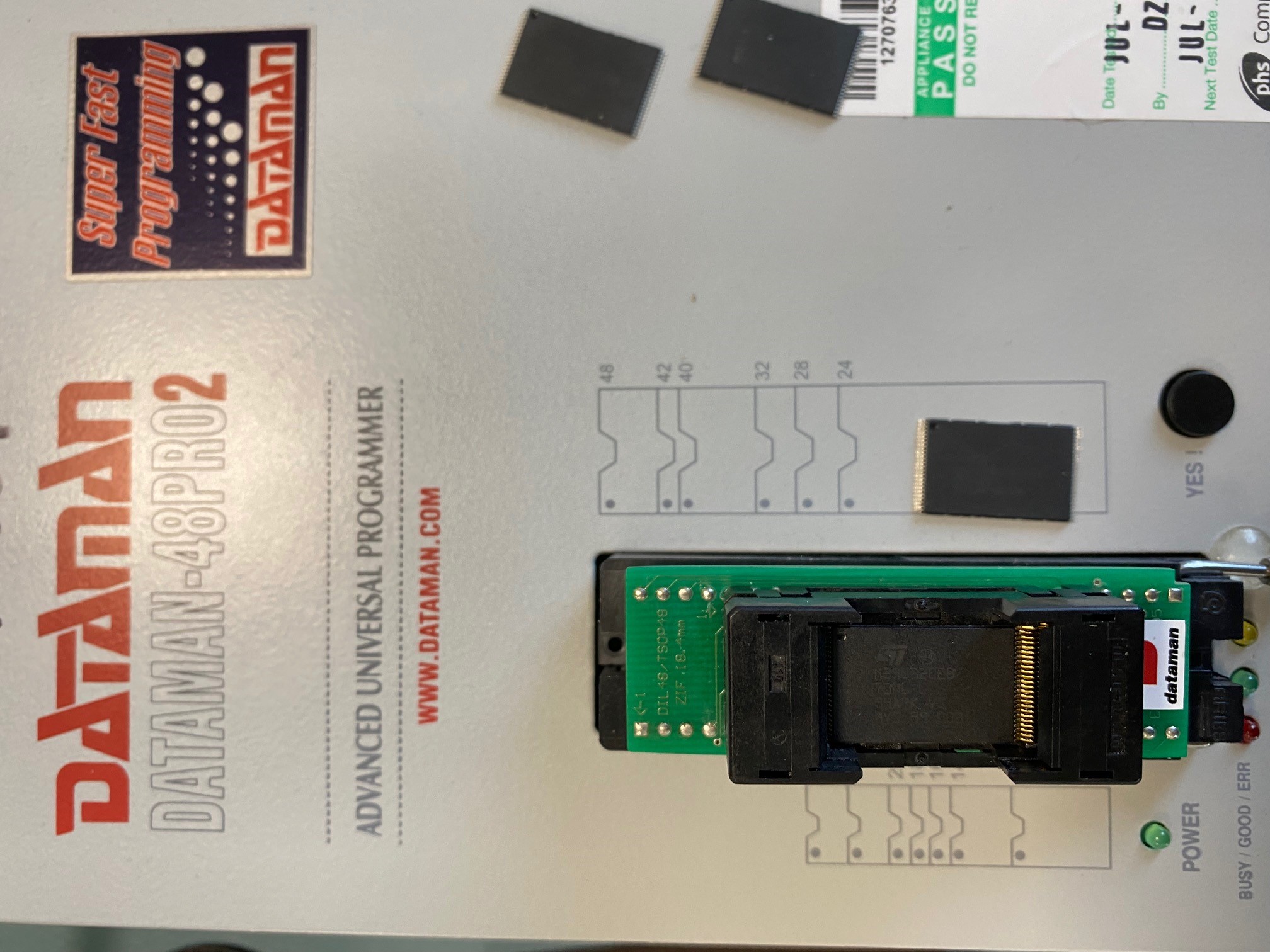

Please see attachments for more information.

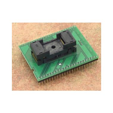

The socket shown in the photo does not look like the (Bottom TSOP48 NOR-1) + (Top TSOP48 ZIF 18.4mm) combination.
This is an image of the Top TSOP48 ZIF 18.4mm: As you can see the PCB area is a lot bigger.
Please purchase the top and bottom parts of this socket from our website here in order to read and program the mentioned device:
Bottom TSOP48 NOR-1
If you have any further questions please do not hesitate to contact us.
