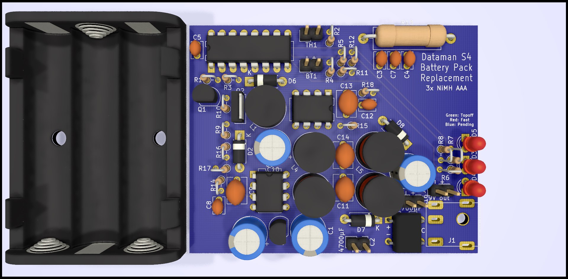

As part of restoring a second-hand S4 for my own hobbyist use, I'm building an adapter board to replace the original power jack and battery pack (which are both dead in my example). This board should comfortably fit in the battery compartment along with a 3x AAA holder. I'll need to cut a small window in the side of the case to access a new, more robust power jack mounted on the new board, and view some status LEDs beside it.
The adapter board incorporates two Cuk converters and a NiMH battery charger. One of the Cuk converters is a direct path from the new jack to the S4's battery terminals, supplying a steady 9.4V. The other one supplies 8.6V derived from the NiMH battery, and is thus idle when external power is present. The battery charger (a BQ2004) performs a safe two-hour fast-charge cycle, using the best practices of peak-voltage detection, thermal rise, and safety timeouts, via a simple buck converter and current-sensing resistor.
The watt-hour capacity of three AAA NiMH cells is maybe half that of a seven-cell NiCad AA pack, but since they can be obtained cheaply from any reputable supermarket, I expect this will greatly extend the useful lifetime of my unit. I suppose with a SMD version of the design, the board might be shrunk enough to fit a 3x AA holder, which would have a greater watt-hour capacity than the original pack.
The direct, properly stabilised path from supply to output is also likely to be kinder to the cells than the original design; based on the rather small capacitors fitted, I can only assume that the battery was used as a ballast when externally powered. For this reason, my design includes provisions to attach large capacitors to both the input and output, though they'll have to be stashed elsewhere in the unit's casing. There seems to be a suitable place in the vicinity of the contrast knob.
I'll post again when I'm further along with the project. I may even have some spare bare boards from whichever small-batch manufacturer I end up using.
