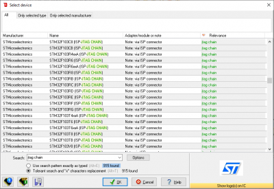

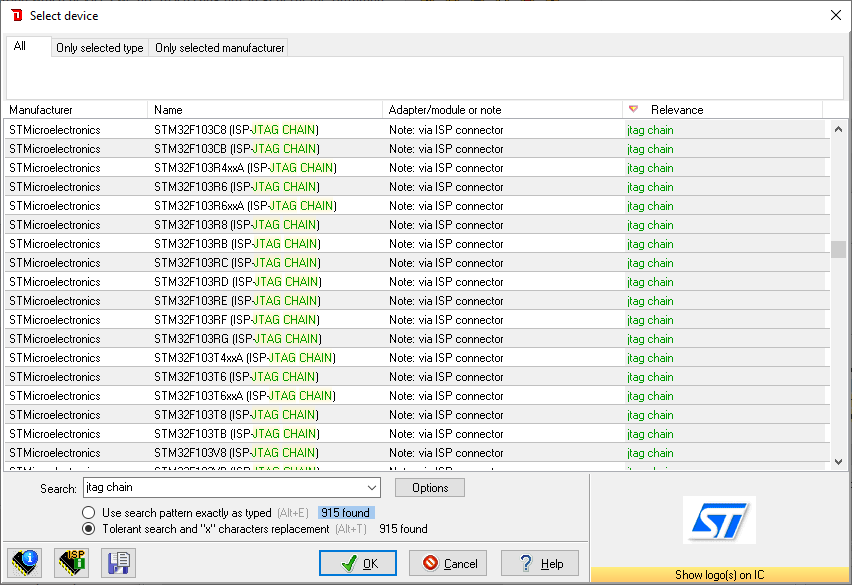

Thank you for posting on our forum. You do not mention which devices we are discussing so I cannot confirm if we support them or not but in general the Dataman-48Pro2 does support JTAG chains:
I would recommend that you download the control software for the 48Pro2, which will run completly unrestricted in DEMO mode and have a look at the recommended target system schematics for ISP JTAG Chain devices.
