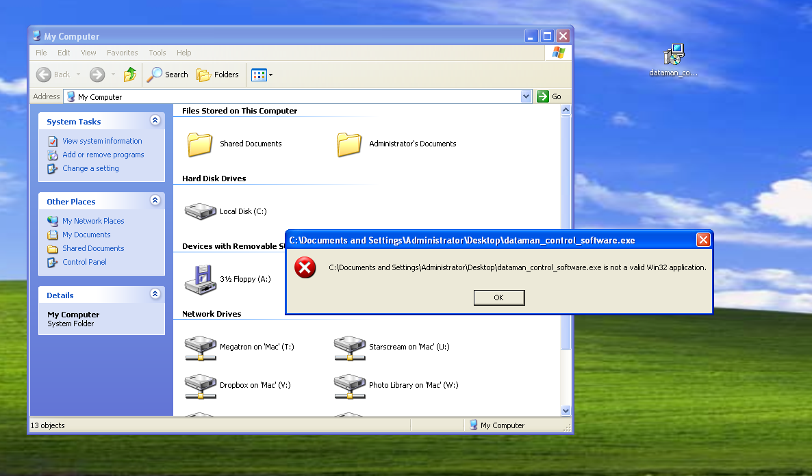

Re: v3.6 update says not a valid win32 application on Win XP
Tried it on another xp machine. Same result See pic
Hello Jim,
Our engineers have informed me that this is a bug that was introduced into the installer in v3.60 and it was fixed in 3.60d.
The latest version v3.60z09 or later can be downloaded from our website here:
https://www.dataman.com/mwdownloads/dow ... nk/id/202/
Apologies for this inconvenience.
