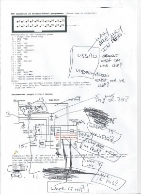

If your able to navigate to the chip in question you'll see in the picture , the wiring illustrations there all over place with wires and illustrations wiring locations keys there all over place.
Now there is a large portion of the page which can be used for say, for a chip? For instance, that wire lines could come from there respective pins then they would lead over to the ISP. Connector , and if it requires a inline resistor. For voltage drop pull down or whatever. Put it in there. And only show the pins required. Not a heep of jargon.
Now if this was a 200 quid machine I'd be like well that's what I get. But this machine is over a a grand and I expect better , much better , if a 3rd party programmer can give good illustrations (which is almost the same price range) why can't dataman. ?
I was making my own rough drawing today. (:had another Job to get on with) To show how I think it should look like. I'll upload it to you once I'm done and you can let me know what you think.?

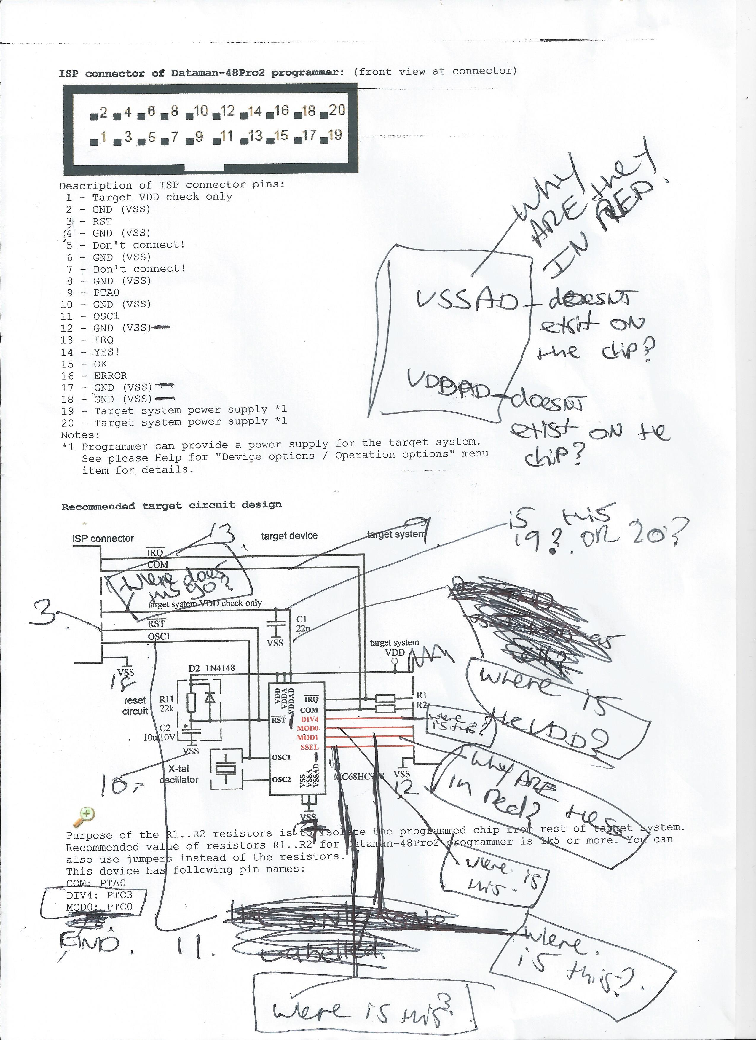

Postby tomanycars » 10 Jun 2021 21:53
so i have attached what i had to use to work out the pin locations for the target device , in question. as you can see i have made abit of a mess of the sheet but you can see where i am coming from. that who ever wrote the illustration kinda just gave up and just , .... thought that will do!
fortunility i managed to decipher the jargon as said in the previous message. hope this helps in your meeting you might have hopefully you can make sense of what i am trying to let you know about.
i have received my first test device which i will try on the Dataman and see what the results might be.... i will let you know how i get on and even send my test results if you want....? it wont be yet as i am due to go annual leave soon.
just to add this is a MC68HC08AZ32A
thanks
i await your feed back!

Neil if you was wondering why i circled END around DIV4(PTC3) and MOD4(PTC0), its to do with it being on the data sheet of the MCU at the end of the chip. next to the dot mark.
I just thought id clear that bit up before there was any extra confusion.

Your page of notes were shown to our engineers but it was not entirely clear and quite hard to follow. Perhaps you could recreate the schematic and ISP connector in the same style that you would expect to see in our software.

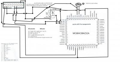

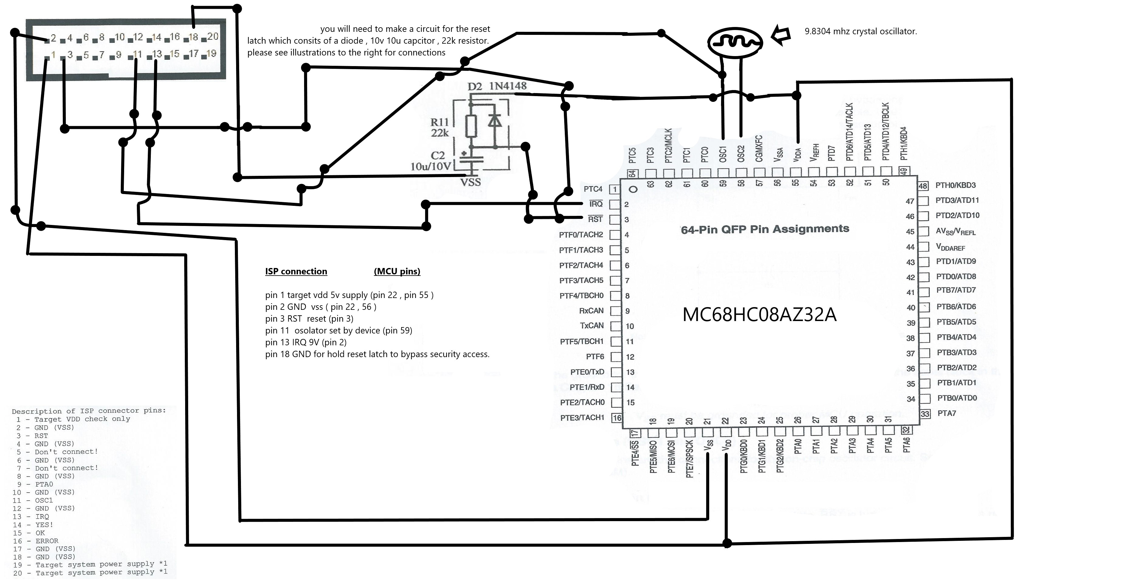

hi Neil, so i have made a very rough way i think it should look , I have the manufactories data sheet and the data sheet you handed over.
and kind of made one out of it.
I was trying to work out why there was a small circuit which has the following.
x1 22w resistor
x1 zener diode
x1 10v 10u capacitor
so I figured it was down to the discharge rate to allow access to the executive mode of the target chip , and bypass security access.?
it was a little confusing as the manufactures data sheet suggests that a max232 , will need to be used to me terminated at pin PAT0 & IRQ , with the various diodes
and also there is a suggestion to use a 4.9152mhz crystal apposed to the 9.8304mhz ? I'll continue through the data sheet maybe i have missed the reason for the difference in crystals.
i haven't tested it yet as i am still awaiting my test device which is from a vehicle. once it is here i will gladly test it out and then send over the results. fingers crossed it works.
Now when i read the 3rd parties access a different way and access via the PATO pin , and gains access via security bytes access , which the Dataman diagram & the manufacturer datasheet kinda suggests , i plan to look further into it when i have a free moment..
Now regarding that why none of your customers have not complained about it , i don't know maybe they figured well i have multiple devices so i will get to where i want to be with something else who knows. ?
the only reason I'm going down this path , i saw the Dataman i purchased has the capability of accessing this chip , i wanted to see what it can do but me being able to understand the diagram is key. i couldn't really wait around while i deciphered the diagram when i have a 3rd party device which shows me what i want to see. a connection diagram. etc
i know the one i made has errors as i am running of what i can see. but i think we can come to a good resolution from this. i would hope.
