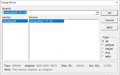

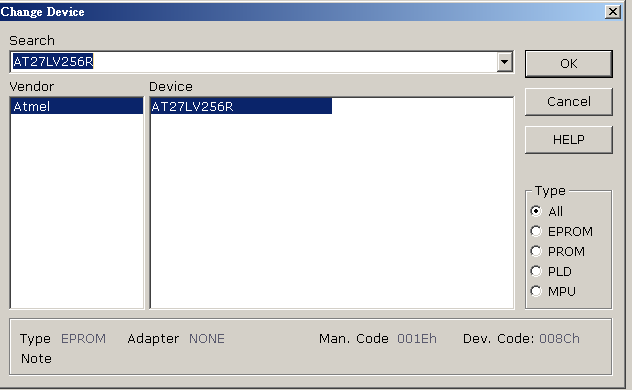

Good news, both devices can be programmed using the 48UXP using the following selections in the software:
Please select 48UXP SW device S29GL064S-TF-04 to program Cypress S29GL064S70TFI070 device with TSOP48 package.
Please select 48UXP SW device AT27LV256R to program Atmel's AT27LV256A-90JU (32KB EPROM).
The SDP-UNIV-48TS socket can be found on our website here: https://www.dataman.com/sdp-univ-48ts.html
