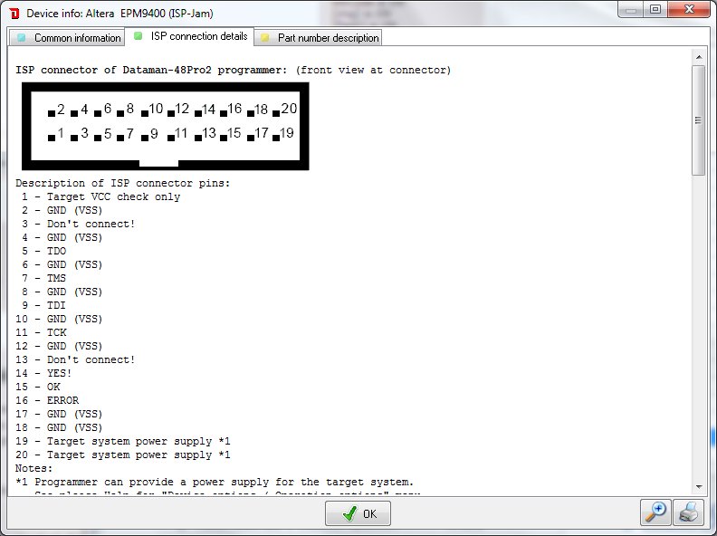

I have a legacy 40Pro which does not support Altera MAX EPM9400 208pin devices. So, am considering purchase of a 48Pro2 or 48Pro2C.
I had a look at the manual and specifications for both. Can not see a mapping between DATAMAN pinout for ISP cable and standard JTAG pinout however. The boards I have with the Altera EMP9400 devices have a 10 pin JTAG ( which I presume is an Altera specific pinout probably to match their cables ). Would like to be certain of which DATAMAN ISP cable pins match with standard JTAG signals ( only 4 I believe, plus GNDs and power ).
The ISP cable on 48Pro2/C is 20 pin, while the 40Pro is 10 pin, and likewise the JTAG pins on my board. Can I presume the additional 10 pins on the 20 pin connectors are redundant ?
Possibly there is a document mapping DATAMAN ISP pinout to standard JTAG ? a pointer or link to such would appreciated. Or any advice on best way to proceed.

Hello seandeg,
The pinout description of the ISP connector is provided in the control software itself. When a device is selected in ISP mode (ISP) then under the "Device info" there is a tab called "ISP connection details":
I hope this helps.

Re: 48Pro2/2C for ISP of Altera EPM9400 208pin
Thanks Neil,
that answers all JTAG related questions I think. Great response.
