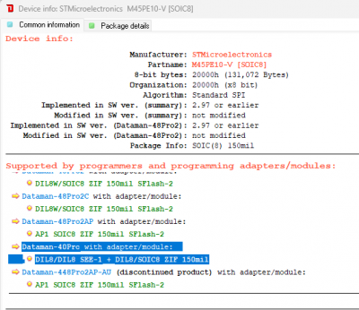

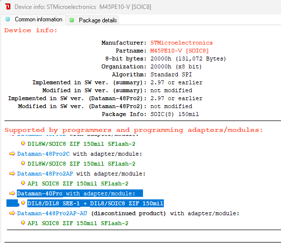

I can see that this device when used on the Dataman-40Pro requires an extra adaptor:

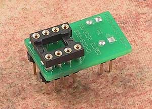

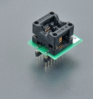

Can you confirm that you have both the DIL8/DIL8 SEE-1 and DIL8/SOIC8 ZIF 150mil adaptors?
DIL8/DIL8 SEE-1:
DIL8/SOIC8 ZIF 150mil: If you have any questions, please do not hesitate to contact me.
