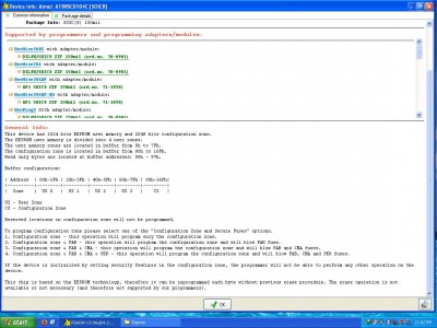

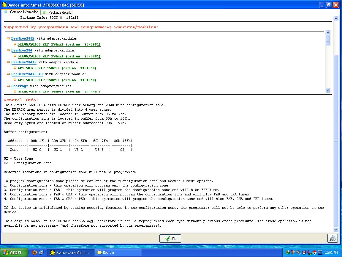

In addition to the information we provide in our software I recommend that you reference the datasheet in order to understand exactly how this device operates.
It is worth noting that it has a security feature which, if set, means that you will not be able to read or copy the contents to a new device.

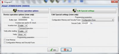

With the AT88SC0104C [SOIC8] device selected in the software please click on the Load button and navigate to your binary file, click Open. Your file will now be loaded into the software.
Next, click on the "Program" button and you will be presented with the following window: Depending on your requirements you will need to select the "User memory" option and if required, the "Configuration Memory and Security Fuses" option. With these options set as required, simply hit the Yes button and programming will begin.
