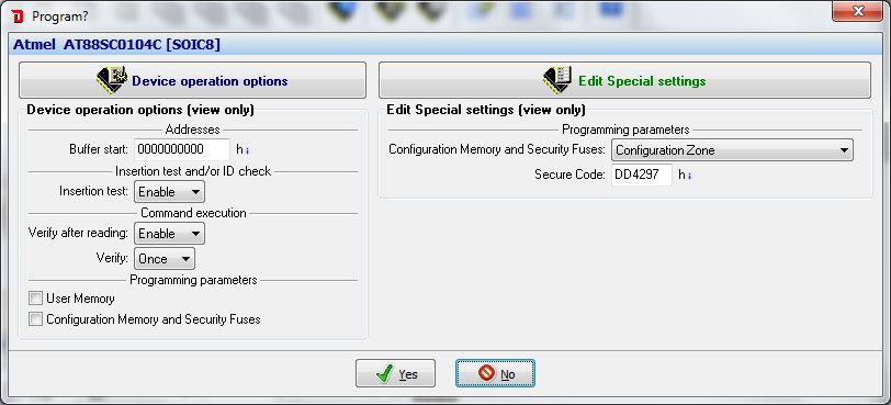

With the AT88SC0104C [SOIC8] device selected in the software please click on the Load button and navigate to your binary file, click Open. Your file will now be loaded into the software.
Next, click on the "Program" button and you will be presented with the following window:
Depending on your requirements you will need to select the "User memory" option and if required, the "Configuration Memory and Security Fuses" option. With these options set as required, simply hit the Yes button and programming will begin.
If you encounter any errors or messages then please use the "Help menu > Create problem report" feature and email the resulting log file to [email protected] for analysis.
Please let me know how you get on.
