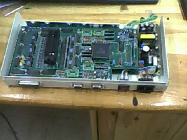

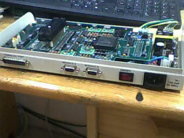

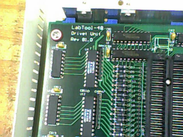

Thank you for your reply, I have two LabTool 48 with xp upgrade kit, the first does not connect with the soft6.70 accepts 4.67 and the app displays LabTool-48 firmware version 2.20, 2nd does not connect.
What should I do?
Note: I can send you pictures.
What should I do?
Dataman (Neil Parker)
- Posts: 989
- Joined: 10 Nov 2011 09:51
Re: upgrade labtool 48 ?
Hello free4sat,
You mention that you have 2 Labtool programmers and they are both upgraded to Labtool-48XP models, correct?
If they are in fact XP versions then they should not work with software v4.67. Software v4.67 is only suitable for use with the original Labtool-48 and the Labtool-48LV models.
The Labtool-48XP/UXP models must use software version v8.32 or above.
Below are the upgrade paths showing which versions of the programmers can be upgraded to the latest UXP version and also how to identify the different versions.
A. D-48 (Firmware Version 1.9) *(1) can not be upgraded to D-48UXP.
B. D-48/LV (Firmware Version 2.0 and Above) *(2) can be upgraded to D-48UXP, please order the UXP Upgrade Kit.
C. D-48XP can be upgraded to D-48UXP, please order the UXP Upgrade Kit.
*1: No support for 3.3V device, upper PCB version is A3.0 or earlier
*2: Support for 3.3V device, upper PCB version is B1.0
You did not mention which version of Windows you are using, please specify.
If you are sure that your second programmer has been upgraded to the 48XP version but it does not connect the with the software then I would suspect a problem and I would advise that you send to the programmer to us for analysis in our lab.
If you have any questions, please contact me.
Best regards,
Neil Parker
Dataman Programmers

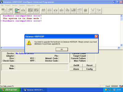

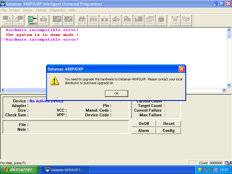

Hi, thanks for your replly, I 've tried to run the soft 8.3 on windows xp but not work, and i have this message you need to upgrade your hardware to xp/uxp.
and like you can see the previous photos i have upgrade my labtool with the kit.
here you can find a photo with the error Thanks for you help.
- Posts: 989
Hi free4sat,
Based on that error message it does not look like you have the XP or UXP upgrade kit installed.
One way to find out exactly which model you have is to provide me with the selftest AExxxxxxxxx.rep file.
Please install whichever software version allows you to connect to the programmer, v4.67 or v8.32.Once installed, please connect your programmer and run the self test function (F7) on your programmer as it is and send the resulting self test report file *.rep to us.
You can find the self test report file here (Windows 2000/XP/Vista/7) C:\Program Files\Dataman Programmers Ltd.\Dataman-48UXP\AExxxxxxxxxx.rep where the AE number will be the unique serial number of your programmer. Alternatively search on your PC for "*.rep" and the last modified file will be the correct one.
Please generate this .rep file and send it to me using the upload attachment feature of this forum or email it [email protected]
