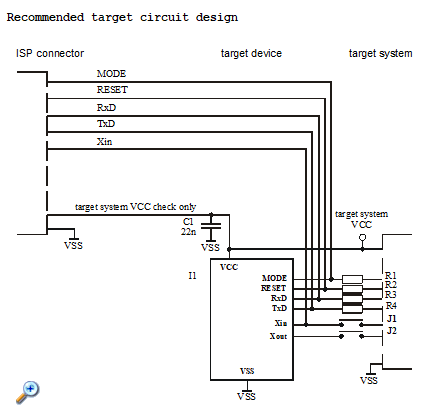

Hello.I have a mainboard to reprogram with r5f21258 .the connector to do the job have only
vcc gnd reset and mode connected to micro.the my dataman need to connect more pin.
how can i do the reprogramming without solder a more wire?
renesas r5f21258

Re: renesas r5f21258
Hello I have same trouble with ISP connector of BeeProg2 programmer.
Is not clear for me how connect my programmer with recommended target circuit design to mcu.
Sorry for my poor English
I 'ld like connect the programmer without using 2 wire interface
Hello totore69,
Please tell me which signals you have available on your PCB/MCU.
We support the R5F21258SNFP device in two ISP modes:
R5F21258SNFP (ISP)
and
R5F21258SNFP (ISP-single wire)
Please check the software for the full ISP connection details under the "Device info" section.
Depending on which signals you have access to on your PCB/MCU you must chose the appropriate selection in the software.
Device info of r5f21258 ( r8c/25 ) don't have txd and rxd description.Regards
Description of ISP connector pins:
1 - Target VCC check only
2 - GND (VSS)
3 - Don't connect!
4 - GND (VSS)
5 - MODE
6 - GND (VSS)
7 - RESET
8 - GND (VSS)
9 - RxD (pin P0_0 for R8C/10, pin P4_5 for R8C/14,15,1A,1B,26,27,28,29 group, pin P1_5 for R8C/33,34,35,36 group, pin P1_6 for R8C/M1,M13B group, pin P8_6 for R8C/LAPR, LA3A, LA5A, LA8A group, pin P6_7 for R8C/20,21,2A,2B group, pin P13_2 for R8C/L3xC group)
10 - GND (VSS)
11 - Xin
12 - GND (VSS)
13 - TxD (pin P3_7 for R8C/10,14,15,1A,1B,26,27,28,29 group, pin P1_4 for R8C/33,34,35,36,M1,M13B group, pin P8_5 for R8C/LAPR, LA3A, LA5A, LA8A group, pin P6_6 for R8C/20,21,2A,2B group, pin P13_1 for R8C/L3xC group)
14 - YES!
15 - OK
16 - ERROR
17 - GND (VSS)
18 - GND (VSS)
19 - Target system power supply *1
20 - Target system power supply *1
Notes:
*1 Programmer can provide a power supply for the target system.
See please Help for "Device options / Operation options" menu
item for details.
I don't see r8c/25

Dataman (Neil Parker)
- Posts: 986
- Joined: 10 Nov 2011 09:51
Hello totore69,
You are correct, I apologise for the missing information. We have added the R8C/25 ISP pins details to the description of the ISP connector.
Please download, install and use the latest software version released today:
