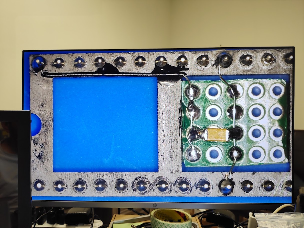

Can you confirm that you have implimented the bypass capacitor mentioned in the "Device info" section of the software:
General Info:
In case of unreliable work of this device using universal adapter/module, please connect bypass capacitor (ceramic multilayer, that meet the EIA X7R or Z5U specification value 22nF-100nF) between GND(VSS) and VCC(VDD) pins of this device.
We provide a programming adapter DIL40/DIL40 ZIF AddCap (70-0802) with special soldering pads for better placing of some capacitors. The programming adapter package (70-0802) also contains 5 pieces of 100nF and 5 pieces of 100pF ceramic capacitors.
General Info:
