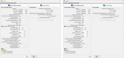

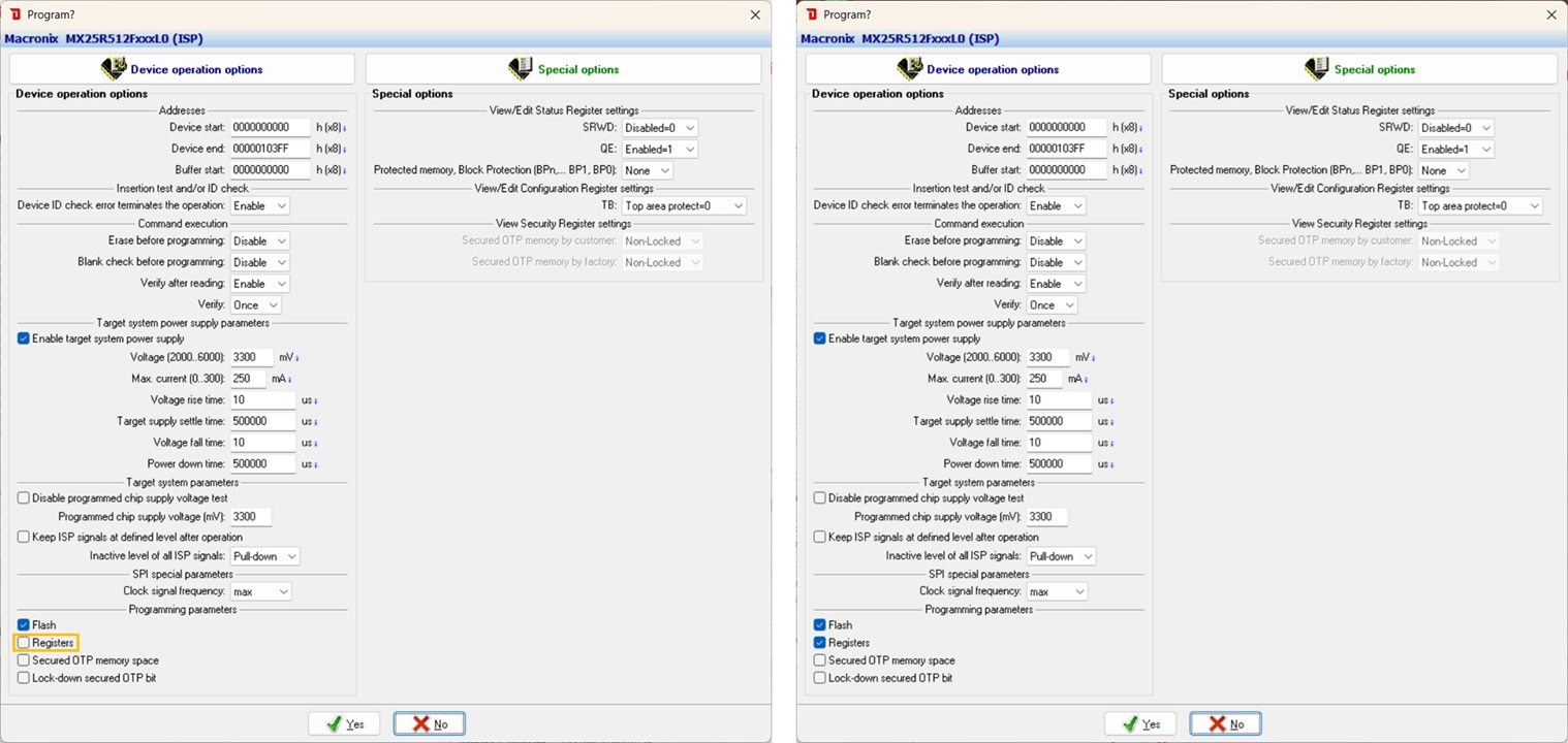

1. What is the difference between "Registers" checked or not checked?
It is the same as the "Flash" checkbox or the other checkboxes. Checked = program this area, unchecked = don't program this area.

> 3. For QE enabled, can we program the main content first, verify and then program the "Special options"? if yes how to do it?
Yes, you can. In the "Programming parameters", check the Flash and Registers checkboxes and in the "Special Options" set the QE as Enabled = 1.
