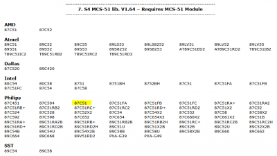

I am trying to program a philips p87c51ubpn , but this type not in any library that i downloaded from the dataman site.
Is there another way to program it

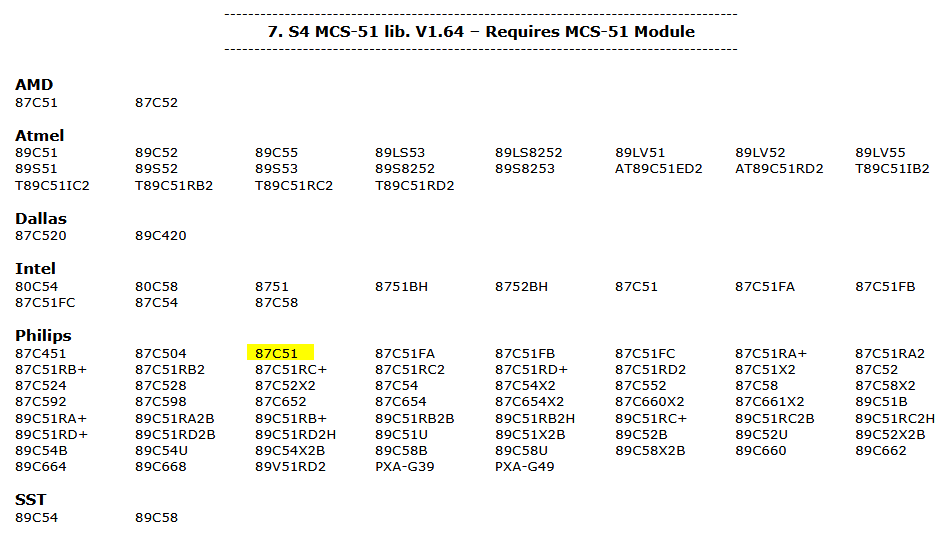

Hello grover64,
Thank you for posting in our user forum. The Dataman S4 supports several different versions of the 87C51 device under the (S4 MCS-51 lib. V1.64) which also requires the MCS-51 Module.
Please try selecting the following algorithm under the Philips manufacturer:
If you need a simpler solution to programming the P87C51UBPN device then I would recommend the Dataman-40Pro Universal 40pin Programmer which comes with everything you need to read and program this device oithout the need for any additional modules.
