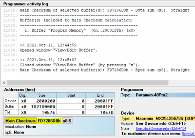

I have an unmodified version of the BIN file i have taken from the flash. i just ran it through the dataman and i completely didn't see it "see's" the current checksum in the activity log Duh to me!.. the current checksum of the unmodified file is FA55C4C9h, i have done a test run on the recalculation of the unmodified BIN, so i can understand how the dataman checksum calculates the checksum. i run the option "copy settings into buffer , from & TO" then Proceed to the next page with all the MD5 hash's & byte WORD etc , its recalculated the checksum for me but it asks me to ...."insert address", i have skim read the help me section but its not very clear what that actually is meant to mean , i did try and look to see if i could find where the current checksum is located but again its not very clear either. , i can only assume that means insert recalculated checksum at an address location :?: :?:

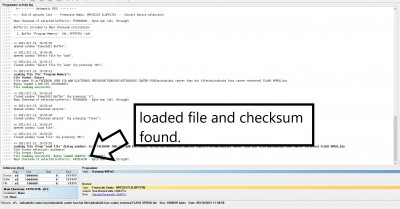

the picture below is me loading the file i wish to be able too perform a checksum on. currently the dataman doesn't have the chip loaded , so please ignore the fact a MPC chip has been selected.
its probably me explaining very badly :cry:

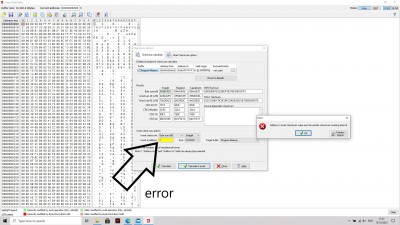

next it comes up with an error. but this is the bit that is a little confusing as its not exactly clear what that is meant to mean.
so in summary what i want to do is edit this file shown in the examples , but recalculate the file and then flash it back to the target chip. but i keep getting an error which isn't very clear at all

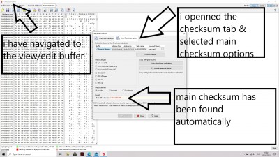

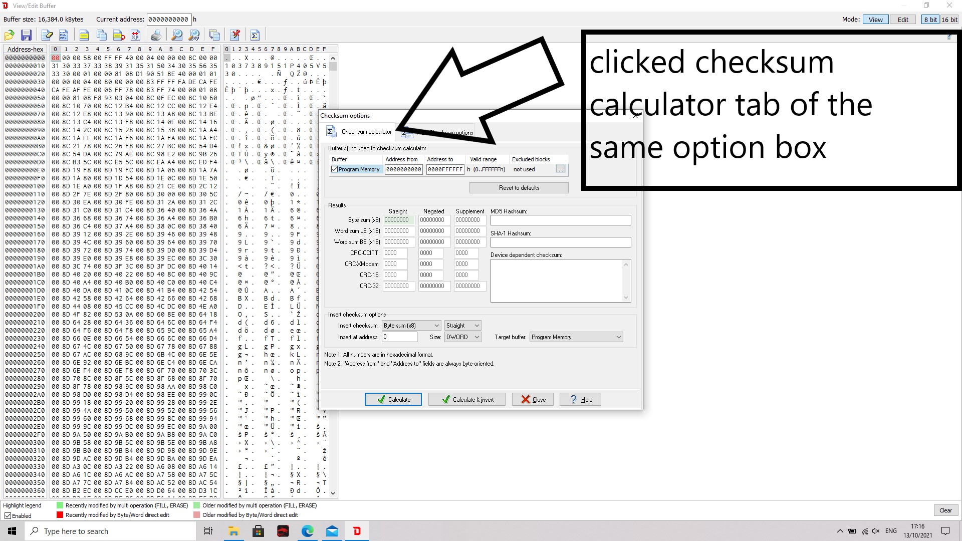

the picture below is when i navigate to the view/buffer section. i selected checksum , and then clicked the main checksum options , the .bin files checksum has been found

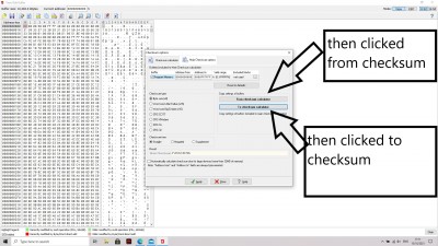

then i clicked the from & to option to fill the checksum information. i then pressed apply.

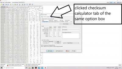

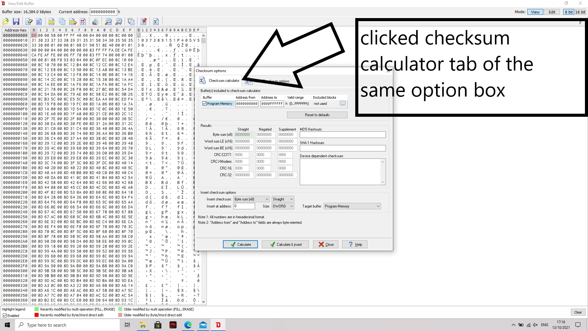

then i moved over too the next tab

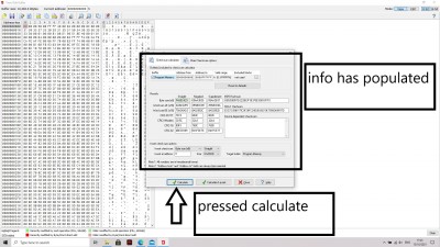

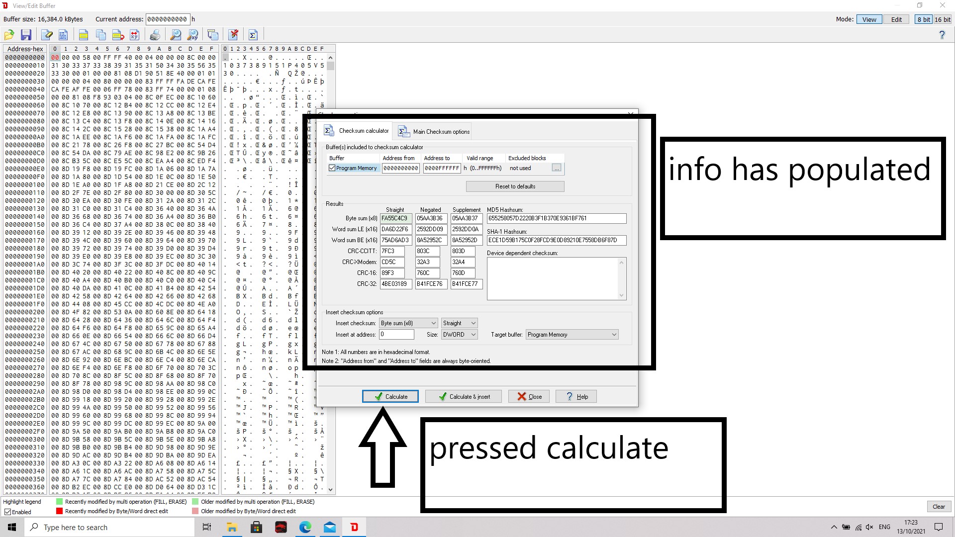

then i clicked calculate. and then it populated the info
then i clicked calculate and insert but i get an error.

Postby Dataman (Neil Parker) » 14 Oct 2021 09:03
OK, the error message appears to be telling you that you cannot insert the calculated checksum starting at an address that was used as part of the checksum calculation itself.
You must specify an address outside the range of addresses that you were calculating the checksum over.

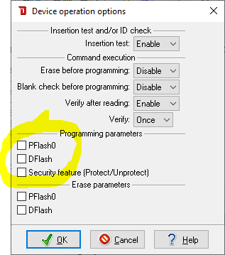

Did you see the info that we provide for this device:
General Info:
Flash module PFlash0 includes 2MB of PFlash memory - buffer named PFlash0.
DFlash includes 64kB of additional data flash memory - buffer named DFlash.
Supported address range:
PFlash0 - 80000000h-801FFFFFh, A0000000h-A01FFFFFh, mapped to 0h-1FFFFFh (buffer named PFlash0)
DFlash0 - 8FE00000h-8FE07FFFh, AFE00000h-AFE07FFFh, mapped to 0h-7FFFh (buffer named DFlash)
DFlash1 - 8FE10000h-8FE17FFFh, AFE10000h-AFE17FFFh, mapped to 8000h-FFFFh (buffer named DFlash)
Due to internal technical reasons of software the save file is supported only as Intel HEX file type, we are sorry for this inconvenience.
If you have performed a READ on a master device then the data in the buffer or the HEX file if you save it out to your PC contains all the information from the device, in the correct places. In order to program this data onto a new blank device you just need to make sure you select the correct areas of the device to program based on the buffer data you observe from the master device:
If there is a date in all mentioned locations then you would select all three areas to program.
