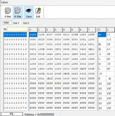

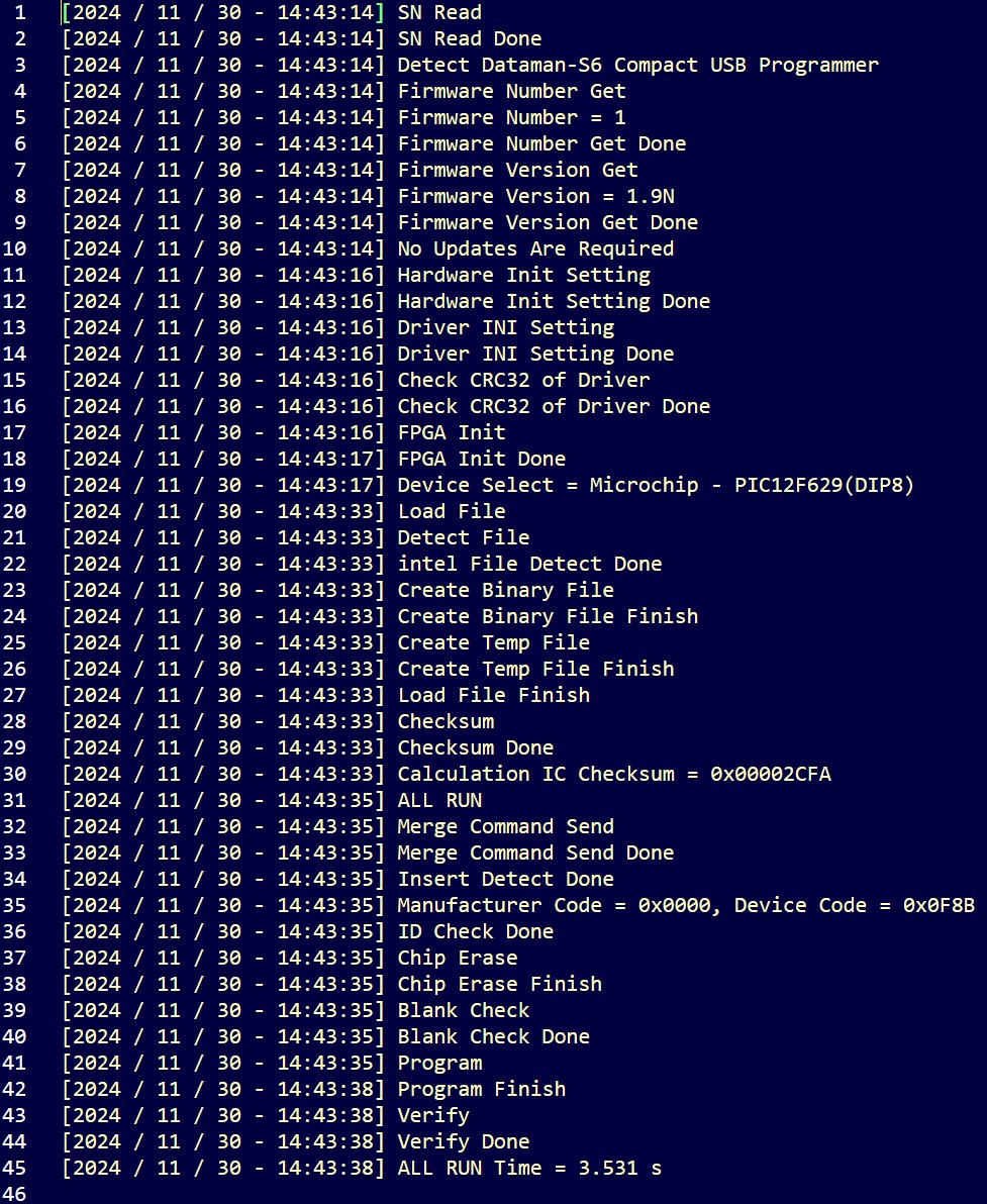

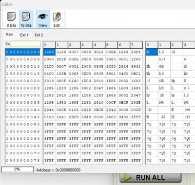

I'm attempting to write a hex file using the S6 program PIC12F629(DIP8). The written CRC hex file doesn't match the original hex file. I noticed the original hex file contains FFFF in the unwritten/empty fields but the written hex contains 3FFF instead. Attached screenshots of the hex views from Dataman and the log file.

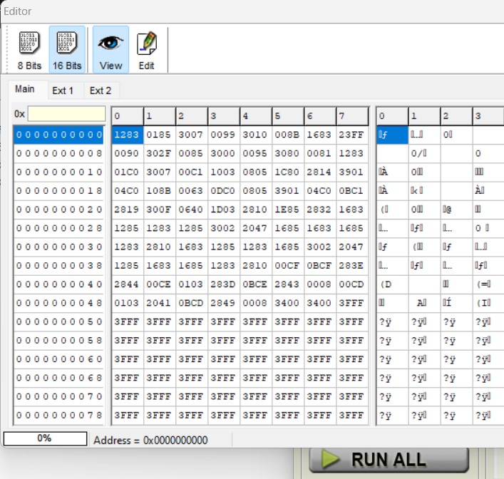

The values seen in the buffer are the default blank states of the two devices based on their organisation:
PIC12F629
Organisation: 400h (x14 bit)
Default blank state: 3FFF
PIC12F529
Organisation: 600h (x12 bit)
Default blank state: 0FFF
In general, when working with PIC devices it is a good idea to read a blank device into the buffer before loading your hex file. This way any gaps in your file will have the correct blank state in the buffer.
